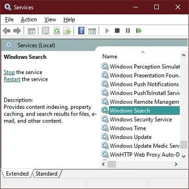

Windows Search
Windows Search is safe to disable and can have a noticeable effect on your performance because it also disables the Windows search indexer. It’s not something we recommend most people do, however. Instant, fast search performance is one of the best features of Windows 10.
It’s an option if you don’t make much use of Windows search or your CPU is really slow. Go ahead and disable it to see if it boosts performance.
