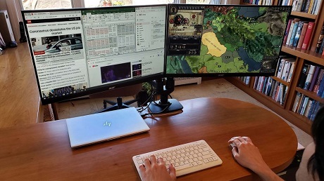

For the visuals, I’ll be using a pair of Acer CB242Y displays. They sell for about $110 each, although the company has refurbished ones for about $100. The screens have 1080p (HD) resolution, a gamer-friendly response rate of 1 millisecond, and very narrow side bezels. This is important because a larger frame would show up where the two screens meet.
For me, the pair of 23.8-inch screens will yield the equivalent of a 43-inch display with a combined resolution of 3840 x1080. More to the point, it will be long and narrow enough to comfortably fit five or six open windows.

1. My first step is to clamp the stand to the desk. I’m using a thin piece of wood to protect the desk’s surface.
2. Next, I put the arm onto the base and got the first display ready.
3. Then, I screwed the mounting plate to the back of the display using the included thumbscrews.
4. Once ready, I put the display on the stand’s arm.
5. I finished by hiding the cables in the arm’s cord tray and pressing in the covers that hide the screw holes.
6. Repeat steps 2 through 5 with the second screen. The displays should look like a pair of wings.
7. Turn the computer on and plug an HDMI cable into the notebook’s port and the first display, followed by plugging the USB C-to-HDMI-adapter cable into the computer and second display.
8. There’s another way: I plug both screens into the Startech MSTCDP122HD with HDMI cables and then plug it into the USB-C port of the host notebook.
9. Either way, the computer’s Display Settings section now shows both screens. Click on Identify and the screens should display a “1/2” (for the host notebook and the left screen), and a “3” (for the right screen).
10. If they don’t match up with what’s on the computer’s display, reverse the cables. Finish by changing the Multiple Displays to Duplicate.
11. I want to use the notebook with its lid shut, so I go to the Advanced Settings section of the Power & Sleep category and set the system to not turn off when I close the lid.
12. I finish up by connecting the wireless transmitter for the wireless keyboard and mouse.
It’s a good idea to do some tweaking. Start by adjusting the height and angle of the screens to make them match. Then, set the distance from your chair to roughly two feet. You have two major layout choices: flat or angled. The former provides a long, narrow view of your apps and data, but you might need to refocus your eyes to see the extremities. The latter allows my head to be in the middle of the action, surrounded by two screens. I suggest setting them at roughly a 150-degree angle, which is a nice compromise.
When I’m happy with the layout, I tighten the stand’s screws with the included hex key.
Relax and enjoy the show
Now that it’s all done, I love the wide expansive view of my digital world. This project was well worth the time, effort, and cost. All told, it’s not only bigger but better than a 42-inch display because, for me, the long narrow 3820 x 1080 resolution provides plenty of room to work with five or six horizontal windows. At a little more than $600 and 45 minutes of my time, the dual-display has transformed my desk and online life.
I frequently use it to play a game of Crusader Kings, while I try to do some work using Word, Excel, and a browser window or two. It all fits without feeling crowded, making everything a lot easier.
