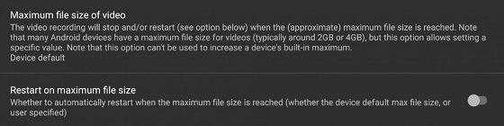

Developers have asked for a way to record video files larger than 4GB in size for years now, and it seems that change could finally be coming in Android 11. According to the description of a new commit in the AOSP Gerrit, Google is updating Android’s media classes to remove the 32-bit file size limitation. Specifically, Android will now “use [a] 64bit offset in mpeg4writer,” which allows Android “to compose/mux files more than 4GB in size.” During testing, Google successfully composed a file of around 32GB in size, and in a separate test, even managed to fill up the entire storage capacity of the phone with a single recording. Maximum file size of 2^64 -1 bytes is comically large and would never really ever be met, so we expect Google to limit the MediaRecorder API or OEMs to limit their stock camera apps to support a more reasonable maximum file size. However, apps like OpenCamera that use the Camera2API should still be able to arbitrarily set whatever maximum file size they want without having to worry about the 32-bit file size limitation.
OpenCamera’s Video Recording Settings
