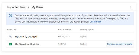

If you head to drive.google.com/drive/update-drives in a browser, you should be able to see a list of your impacted files, and if you mouse over them you'll see a button on the right to remove or apply the security update. "Applied" means the resourcekey will be required after September 13, 2021, and will (mostly) break the old link, while "removed" means the resourcekey isn't required and any links out there should keep working.
Google's "impacted files" interface. Feel free to add or remove that security update.
