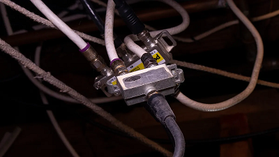

Because of these transitions, millions of homes find themselves with seemingly useless coaxial cables and coaxial outlets emerging from walls and floors. But, don't rip all that cabling out just yet. With a couple of relatively inexpensive adapters, you can use those lines that already spiderweb across your home to carry the same data that would otherwise require hundreds of feet of expensive-to-install Ethernet cabling. In fact, it can connect any two devices that use Ethernet connections – modems, routers, switches, PCs, streaming devices, and more – even if they're on opposite sides of the house. Read on to find out how to turn that idle coaxial into a ready-to-go, whole-home networking asset.

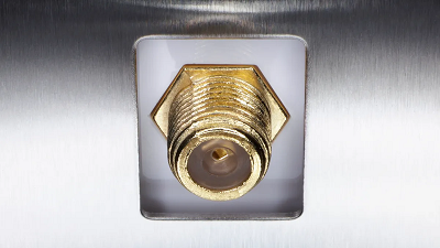

The termination will either look something like this (if it's a wall-mounted port), or like one of the
many cables pictured at the top of the guide. source: Getty Images

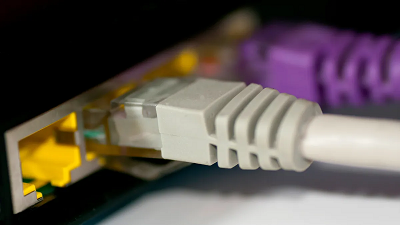

   • Ethernet: will click into the Ethernet port

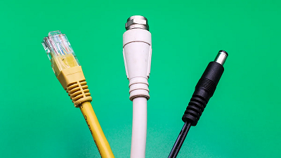

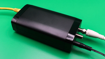

These are (left to right) the Ethernet cable, coaxial cable, and power cable we're connecting to our
adapter. source: Michael Gariffo/ZDNET

Your adapter should look something like this when fully connected. That empty coaxial port is there if
you still want to power a TV over the same cable run, which we don't recommend.
