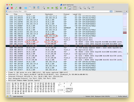

To investigate this issue, we used Wireshark to capture an iOS device’s network traffic.
When you connect a device to VPN, you should only be able to see traffic between the device’s IP and the VPN server or local IP addresses (other devices on your local network). As the capture below shows, there is also direct traffic between the iOS device’s IP and an external IP address that is not the VPN server (in this case it’s an Apple server).
Exposed connections to Apple servers (ProtonVPN) - click to enlarge
10.0.2.109 = iOS device’s IP address
185.159.157.8 = ProtonVPN server
17.57.146.68 = Apple-owned IP address
