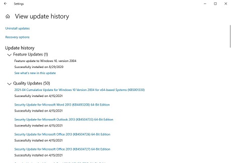

I wanted to check if I experience similar issues with the latest patch,  so I tested the KB5001330 update with my GTX 1650 and had no such troubles. Based on the comments from users, it is possible that the issue only affects newer GPUs like the NVidia 2000, 3000, and AMD R5 series. The thread also suggests an easy fix for the issue, you just have to uninstall the update. You can do so from the Settings > Update & Security > View Update History page.
