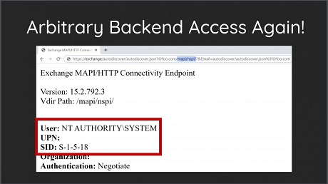

On Thursday, Orange Tsai gave a Black Hat talk about recent Microsoft Exchange vulnerabilities he discovered when targeting the Microsoft Exchange Client Access Service (CAS) attack surface.
As part of the talk, Tsai explained that one of the components of the ProxyShell attack chain targets the Microsoft Exchange Autodiscover service.
Microsoft introduced the Autodiscover service to provide an easy way for mail client software to auto-configure itself with minimal input from the user.
Slide from Orange Tsai's talk showing the Autodiscover URL

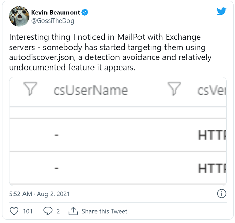

This week, security researcher Kevin Beaumont tweeted that a threat actor was probing his Microsoft Exchange honeypot against the server's Autodiscover service.
While these initial attempts were unsuccessful, last night, after more details about the vulnerability were released, attackers modified their scans to use the new Autodiscover URL disclosed in Tsai's slide above.

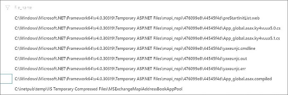

Using the new URL, it appears that the threat actors were successfully able to detect a vulnerable system as it triggers the compilation of the ASP.NET web application.
Jang told BleepingComputer that accessing the URL will cause the ASP.NET worker process (w3wp.exe exe) to compile a web application, as shown in the image below from Beaumont's honeypot.
Files created by the scan on Microsoft Exchange honeypot Source: Twitter
