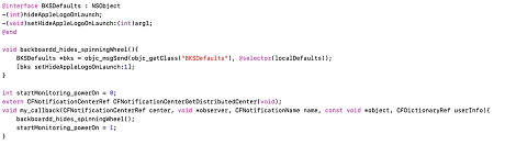

The code in BackBoardd, on the other hand, tells it to hide the spinning wheel animation, which pops up when SpringBoard ceases to work.
Screenshot of code snippets that are injected into SpringBoard and BackBoardd. (Source: ZecOps)
