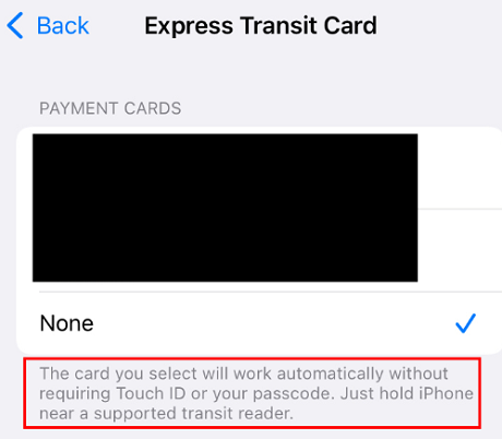

Apple Pay solved the problem with Express Transit, a feature that allows a transaction to go through without unlocking the device.
Express Transit works for specific services, like ticket gates, with card readers that send a non-standard sequence of bytes that bypass the Apple Pay lock screen.

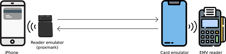

The researchers were able to emulate a ticket-barrier transaction by using a Proxmark device acting as a card reader communicating with the target iPhone and an Android phone with an NFC chip that communicated with a payment terminal.
As seen in the image above, the method is an active man-in-the-middle replay and relay attack where the Proxmark replays the “magic bytes” to the iPhone to trick it into believing that it’s a ticket-gate transaction so user authentication to authorize the payment is not needed.
The attack is more complicated than this, though. The researchers explain that certain flags need to be set by modifying some bits to enable offline data authentication for online transactions, used in readers that may have intermittent connectivity (e.g. transit system entries).
“The attack works by first replaying the Magic Bytes to the iPhone, such that it believes the transaction is happening with a transport EMV reader. Secondly, while relaying the EMV messages, the Terminal Transaction Qualifiers (TTQ), sent by the EMV terminal, need to be modified such that the bits (flags) for Offline Data Authentication (ODA) for Online Authorizations supported and EMV mode supported are set.”
