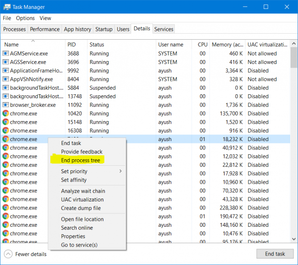

1. For a particular program
This works only in the case of a particular application or program.
Open the Task Manager and click on the Processes (Details) tab.
Look for the process entry that powers your affected program.
Right-click on that specific entry and select End Process Tree.
This will kill all the main and supporting processes for the particular application.
Now launch the killed application again, and check if it loads the new modifications that you just applied.
